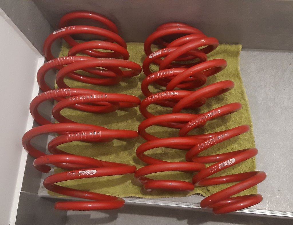

ljubobj Posted November 6, 2022 Author Posted November 6, 2022 Stigao Najdrazi tuning dio Montaza za vikend
