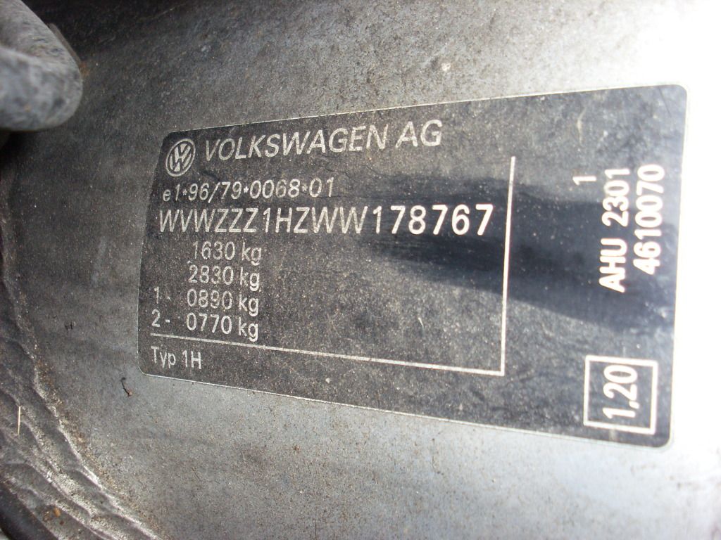

Ivo_022 Posted February 20, 2015 Posted February 20, 2015 (edited) Ljubobj, u motornome prostoru bi trebala biti ovakva naljepnica: http://i260.photobucket.com/albums/ii9/170firebird/TDI%20swap/SL381917.jpg~original Pogledaj mase pod 1- prednja i pod 2-zadnja osovina. To su ukupne dopuštene mase po osovinama. Znači, trebaju ti federi koji nose najmanje toliko kg. edit: Pogledah tehničke podatke, kaže za Golf VI 1.6 TDI 105ks manualni mjenjač, mase po osovinama: 1040kg / 880kg Edited February 20, 2015 by Ivo_022
ljubobj Posted February 20, 2015 Author Posted February 20, 2015 (edited) e hvala kod mene je 1- 1010kg 2- 880kg te mase sam i ja nasao u tehnickim podacima ali na naljepnici je onak kao sto sam napisao 1010 i 880 pa ti sad budi pametan koje uzet Edited February 20, 2015 by ljubobj
Ivo_022 Posted February 20, 2015 Posted February 20, 2015 Najbolje pitaj H&R. Pošalji upit na: info@h-r.com Po mome bi ti trebale ići: 29008-1, prednja osovina od 981kg do 1020kg.
